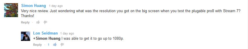

I wonder what resolution you get with Plugable Pro8. It's a Micro USB 2.0 on Stream 7 so bandwidth is limited.
per the Plugable website:
  • DVI-I video output (DisplayLink DL-165 chipset) up to 1920?1080 (1080p) at 60Hz

USB 2.0 has limited bandwidth, so it's hard to get 1080P resolution. So far, the only device confirmed that can get this resolution from Stream 7 is Plugable Pro8

There was noticeable lag when I had it at 1080p. It wasn't a deal breaker by any means, but I could tell... especially since my desktop is a Screaming Gaming Rig, so it's hard not to notice when another device doesn't stand up. Still, this little pad is so amazing, I am more than impressed. We just need to do something about the horrid sound quality. Wish there were some tweaks or EQ's that worked well.
