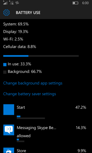

For me it is 'Start'. According to my battery saver info 'Start' is the app using the majority of my battery, mostly in background. I'm assuming this might have something to do with live tiles or the resuming.. Maybe removing all apps from start might help, didn't try.
Restarting does help the problem in the sense it won't continue to drain the battery this time, but it doesn't prevent it from happening again. Already reported via feedback.
