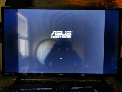

ASUS boot screen followed by nada. Notice that during the ASUS boot screen, it does not take up my full screen. This does not happen when it works as expected.IMG_20180606_171920.jpgIMG_20180606_172003.jpg

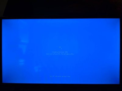

I could not refresh or reinstall Windows and keep my files for some reason. In order to do that, I had to verify my identity with my password, but my PC kept informing me that it was incorrect. The only way I could get my computer back was to completely wipe it clean and reset it. Or, at least that's what I could figure out. I'm no expert on the matter. Now, I can look forward to hours of reinstalling Photoshop, Steam games, apps, and all of my other programs. Fun fun. It might be good to start fresh though.

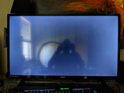

The good thing so far is that it is using the full screen on the display. Fingers are crossed.IMG_20180607_105157.jpg
