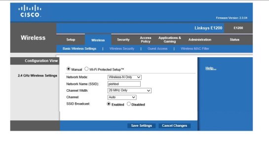

I tried setting the router to N mode only and only had my Surface connected wirelessly and still only get 65mbps. It seems like, for some reason, the max is 65mbps.
