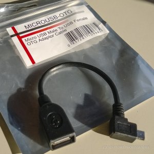

I just got an OTG adapter at Fry's Electronics yesterday that works. Micro USB Male to USB Female OTG Adaptor (Typo is direct from the packaging) Cable. It's USB 2 with a micro connector on one end and a female standard USB port on the other end. I plugged in a Toshiba 640gb external drive and it immediately recognized it and I was able to get to all the files and move them back and forth. I did not have to plug the tablet into a power supply.OTG Cable for N2520.jpg
