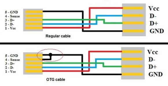

Jerzy Plieth
Jul 23, 2014
20
Re: Need help selecting correct cable & adaptors for my 2520
Yes, any blueooth mouse will work fine.
Also, if you have an OTG micro USB to Standard USB female connector you can connect an RF Mouse just as well.
Our 2520 is host device, not slave, so every USB device can be connected via simple USB adapter, not via OTG!
webkrawler
Dec 6, 2013
75
Umm, I don't know what you mean.
An OTG cable can be connected to the microUSB port and it converts to a regular USB port. This is what you need to plug in anything with a standard USB plug.
Jerzy Plieth
Jul 23, 2014
20
USB OTG or just OTG, is a specification first used in late 2001, that allows USB devices such as digital audio players or mobile phones to act as a host, allowing other USB devices, such as USB flash drive, digital camera, mouse, or keyboard to be attached to them - USB On-The-Go - Wikipedia, the free encyclopedia
Our 2520 is the host device by nature, so it does not need an OTG USB cable; the simple USB<=>USB cable/ adapter is good enough!
The only difference between simple USB<=>USB cable and USB<=>USB OTG is the use an additional pin "sense"
