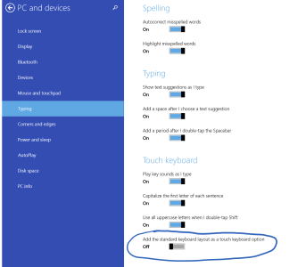

To get the full layout soft keyboard use the PC Settings MUI Control Panel....PC and Devices...Typing and enable....
