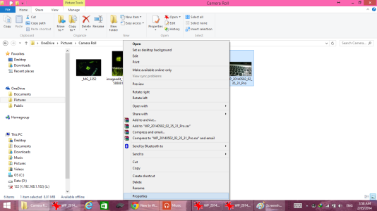

it will upload the full resolution pic :) check your settings in your camera if you're taking the pics in full resolution first and if you're then it will upload the 5MP+16MP picture! if you still want to check the resolution...head to your pc/lappy and...

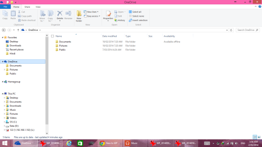

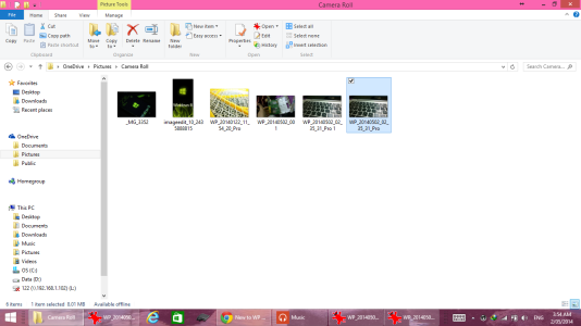

open onedrive from the explorer/my computer
go to pictures....camera roll.....right click on any pic and select properties!
it will show you the resolution of the picture.....if you're still not satisfied

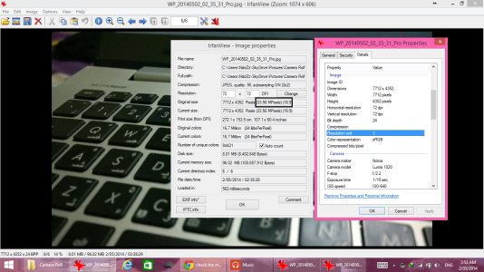

I use IrfanView.....open the pic in IrfanView and press the button "I" in the keyboard....it will show you the image information
hope I helped you :)
this picture is with the properties and the IrfanView Image Information together
P.S - I'm a proud L1020 owner! that's why it's showing 33.56 MP....any other questions whatsoever...feel free to ask :smile:
