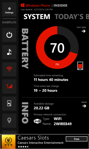

Hey Guys , I'm pretty sure that I found out the problem!
it was Nokia MixRadio Problem!
I turned collect usage data off and there is no heat any more!
I'm super happy!
hope it help you too!
