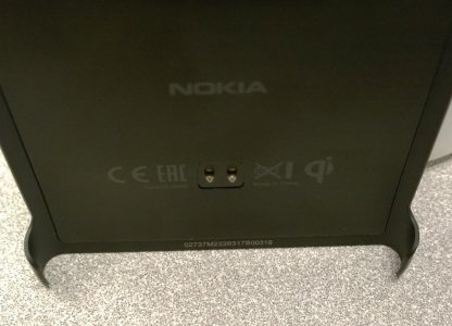

I had the same thing and just fixed it. You need to CAREFULLY pull down the two prongs a bit which are attached to the charging cover. This will cause them to now make contact with the portion inside the phone to create the charge. I did this and it works perfectly now

Like I said just CAREFULLY pull out the little metal stubs on the charging cover and it will work perfectly. It should look like this picture WP_20130809_16_43_04_Pro.jpg
