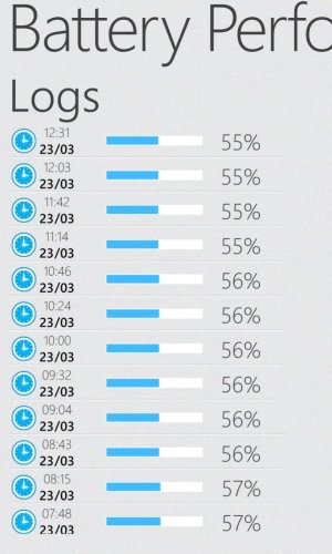

I found my fully charged 1020 estimated 1 day and 17 hours to remain, but just after an hour it tells 6 hours.
There seems to be some inconsistency between OS and the battery.
I'll try to do some charge-discharge cycles to get them consistent.
