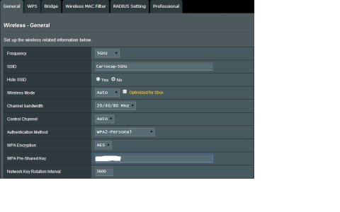

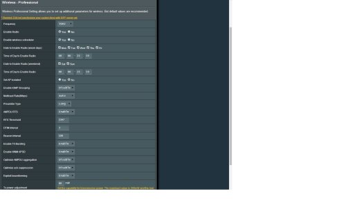

I have an Asus RT-AC66U (5GHz capable) and I connect my Lumia 1520 to it using the 5GHz channel.
Try to restart the phone or check the attached configurations bellow of my 5GHz channel.
Sorry man. Busy at the moment. But I tried some of your settings and got 5 GHz to connect. I will do some speed tests and report my findings. One of the changes I did was my SSID was hidden. I made it visible like you. I'm not sure if that's what the issue was. Like I said I will do some analysis and report back. Thanks for your speedy help!
