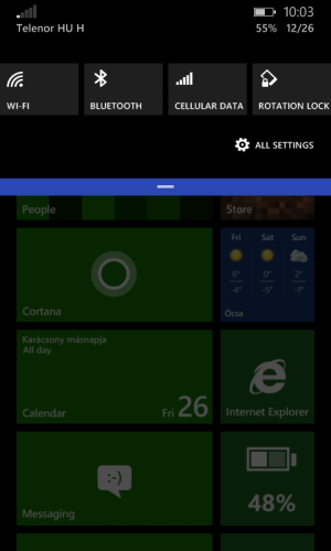

1st bug:
When I open the Notification Bar the new Cellular Data button is sometimes shows the connection is on.
Picture of the normal working.

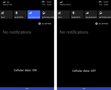

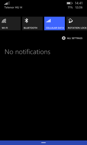

And when the button is "buggy".
