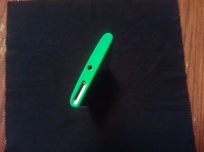

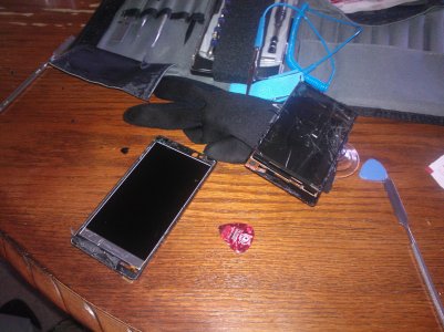

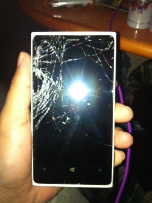

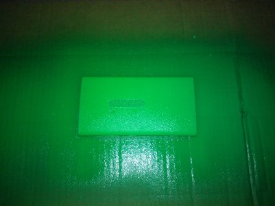

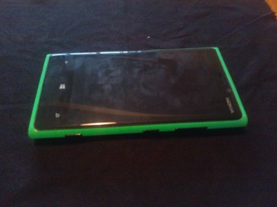

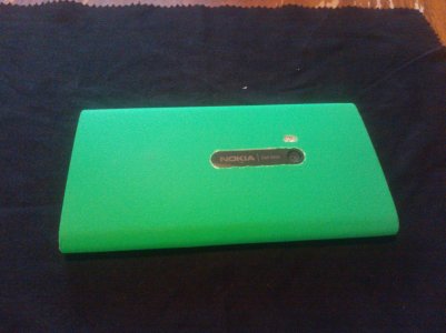

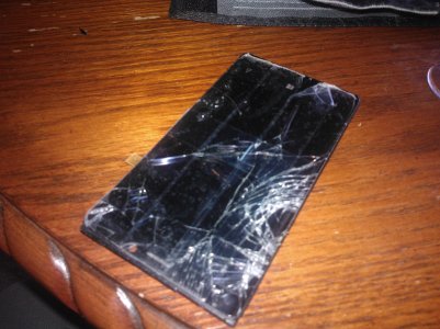

So, I was on vacation dropped my phone and cracked the screen (Thanks a lot St. Martin)... Bought the screen and digitizer and took it upon myself to replace it. Since the new screen doesn't have the ATT logo and just the Nokia logo I figured the warranty is no longer valid (at least through ATT), so why not mess around with the phone and plasti dip it! Here are the results... Best thing of all is that the paint can be removed really easy if I want to revert back to white but not that easy that it will rub off with normal use :-D Let me know what you guys/gals think :-D

Awesome colour. You probably could have found a way to cover up the camera strip and the LED before painting??? - Maybe then the end result would have been better?

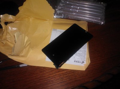

1) I covered the lens and led with frog tape (painters tape) so yeah... Plati Dip is not like your regular paint is really a rubber so it wasn't easy removing the frog tape without lifting the edges a little...
2) E-Bay search for Lumia 920 Screen & Digitizer, I paid 52 bucks and took about 2 weeks to arrive (since is coming from China) but the screen is legit (even if it wasn't it feels legit lol)
3) The installation of the screen can be found on youtube... search for Lumia 920 screen replacement Nokia Lumia 920 Digitizer Glass & LCD (TFT) Display Replacement - YouTube
4) The sellers on ebay usually send out the tools for free but I got the iFix tools kit which brings all the necessary tools I need (expect for a heat gun which you will need to warm up the adhesive, that and the iFix kit i got for X-Mas last year :) )

Might just be because the picture is slightly noisy, but what's the texture like on the final product? It *looks* from those pictures like there's a texturing or a slight dimpling on the final thing... is there?

The texture is rubbery/grainy like a grip...
How many coats did you do? From the looks of it, you sprayed it on pretty thick. On my Tahoe, I did 6 light coats with 15-minutes dry times between each coat. It results in a much smoother finish.

I think you could have gotten away with NOT masking the camera lens. Once Plastidip dries, then you can use an exacto knife to initiate a cut where the lens is. From there you peel the rest off by hand to get a cleaner edge.
Look at the Plastidip My Car Youtube videos. The guy does the same type of thing. Some surfaces you do have to mask, but the lens cover looks to be tightly sealed enough.

If your screen cracks (like mine did) and your display is still functional (i.e. LCD itself did not crack/bleeds ink) then all you have to do is replace the glass screen (technically since the digitizer still works, i.e. The screen is still responsive to touch) but it is a lot easier (and i didn't find just the glass without the digitizer) to replace the glass and digitizer, lucky for us that own the 920 the glass/digitizer/lcd assembly are not completely bonded together like the 900 and other models (like the 928) so it makes it possible to just replace the glass/digitizer and not having to pay for a brand new LCD and frame... All that is really needed is a heat gun / hair drier to loosen up the adhesive. The adhesive came with the screen...
