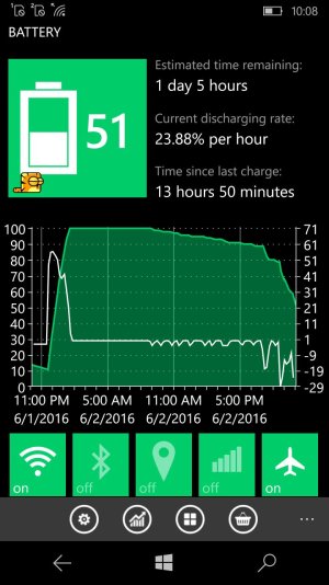

Battery life on 14356.1000 has been phenomenal! I have gotten about close to two days with moderate use.
