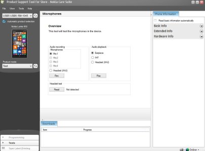

I have the latest Insider build on my Lumia 930, and I noticed that the microphones stopped working. Not sure if it happened after the upgrade from 8.1 to W10 build 10581
In Nokia Care Suite I cannot test all four microphones, only mic #01 is available to test, and it seems to work
The rest are greyed out. Any ideas why?
