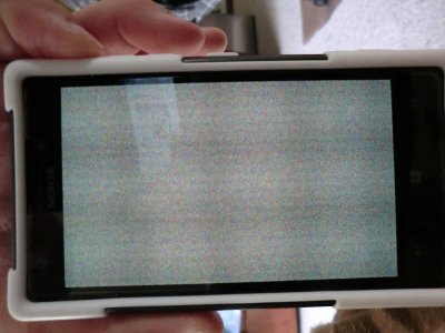

After updating and letting all the apps re-install, reset the phone a couple times as I usually do.
I've had a couple of app / screen freezes, but I could close them and get back to the main screen a few times. This last time, while watching a Youtube video, it froze and eventually showed this:
Hard reset returned device to normal for now. Not sure if it will return. If anyone else has experienced this confirm here.
I've had that sort of thing happen before once every few months.
Nothing a soft reset couldn't fix.
Also, I don't think there's any reason to reset something twice, whether hard or soft.
