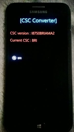

I checked through the threads concerned, and decided to try to see what was available to me on my Ativ S.
Checked the csc and it only has one option, and that is the one that is original to it.
I guess that is because it was bought as an unbranded and carried free new unit.
See picture

Thanks... I do not have the DBT csc.
I have BRI csc... As per picture above, there is no option to change csc.

But if you flash your ROM with DBT one, than you can change csc to ATO and get both, new firmware compatibile with GDR3 and GDR3 update. With that you are up to date until 8.1 firmware from samsung and 8.1 update from MS are released over the air (OTA).

About flashing a new CSC, if you don't know how to do it or don't know what exactly is that, my advice is to NOT do it, cuz chances of you end up with a bricked phone are big. If you have a friends or local service who knows this things, take it there.
