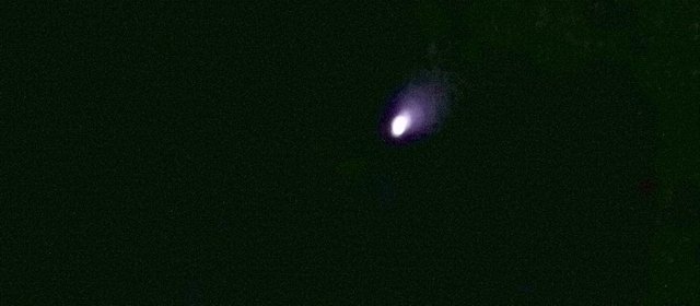

There is no red or blue small light on my l950, as can be seen on this (not very good :) picture

In complete darness I can see absolutelly nothing with neked eyes (maybe it's my eyes :)
The camera sees it as a red dot, but picture processing makes it look as a white dot.
When I lower the darkness in post processing it becomes a red dot as seen on camera viewer
So yes, the red dot exists, only I cannot see it with necked eyes, nor the camera sees it in partly lit environment, sees it only in complete darkness. Probably my sensor emits much lower/weaker light than yours.
Just to add another observation, since I use Auto Brightness I set it, with settings slider, to maximum.
You helped me, thank you. So the light sensor is active all the time, in my case looks like a poor quality, however it does work what it suppose and as I can observe, my battery life is not affected so I decided to live with this beauty mistake.
