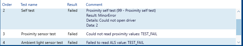

Starting some weeks ago I noticed the proximity sensor doesn't work at all. Also the ambient light sensor doesn't work.
It happened before that they stopped working for a moment but now they totally stopped working. I tried Hard reset and WDRT but no effect. I was on build 15063.

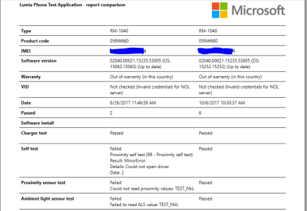

I tried Lumia Phone Test Application and here are the results:
Since the phone is out of warranty, I don't think going to a service center would worth it. Any suggestion?

Last night when I received a call, I noticed the proximity sensor is working again. So I did a test and found the sensors working!
The only Thing I remember I did was connecting headset and listening to FM radio.
