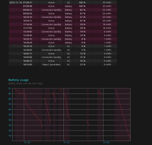

So guys, I wanted to test my Surface (bought a few days ago) battery today, so I let it play some documentaries on YouTube all the day. I startet at 07:11am with 100% and ended my "experiment" at 04:28pm with 4% charge. During that period of time the battery charge went down by 10% per hour. So it was quite nice to see that after 9h 20m it had used 96% of the charge... I think that's quite ok for a tablet... I watched all of the YouTube videos with my wifi-connection. So wifi was on... Display was set at ~25% brightness (that's what I normally use)
I even scanned some documents (my scanner was powered by the usb connection from my Surface entirely)...
Here is a screenshot with some of the data from today (cycle count = 5 btw. maximum charge: 30mWh)
edit: as one can see on the graph the discharge speed was quite stabile. As I mentioned it was about 10%/hour
