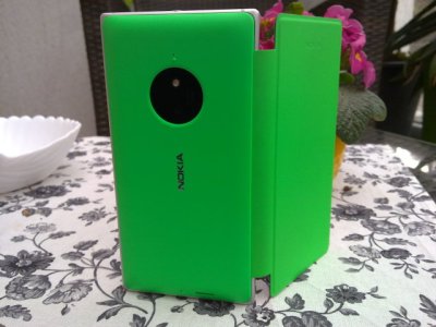

So, I finally made my original flip cover look better.
cool, it really looks nice. I purchased the orange one at MS store. However, after using it for a day I decided it's not what I want. the backplate is a little thicker than the original one and charging gave me issues on third party chargers. Also the screen cover was moving around sideways too much for my taste and I just couldn't get used to open it every time I wanted to use the phone. Back it went....
edit: never mind. I already elaborated on this a couple posts above ;)
I like that the phone is not so thin. And with Nokia sticker on the back, there's no reason for me to use regular cover for some time. :D

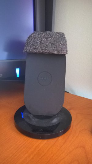

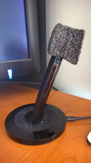

Here's my solution to the international back plates not working correctly w/ the DT-910:
attachment.php
attachment.php
Carved up piece of packing material hollowed out w/ a pocket knife. 5-minute @ job fix! This will place the 830 @ the correct angle to maintain a wireless charging connection. :cool:
