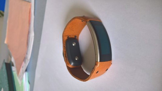

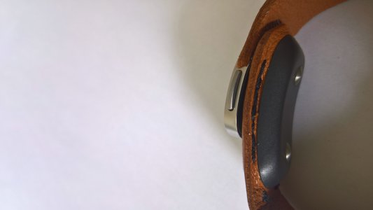

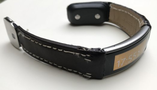

Hi, as almost everyone here, my band 2 had problems with a torn strap....
as I didn't want to buy another one every time it broke I decided to make a little fix for this....
the idea was to replace the silicon rubber band with something more resistant and flexible : leather...

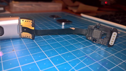

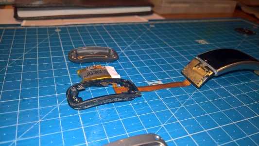

so I basically removed all the silicon strap (VERY VERY carefully and slowly)
then I drill with a Dremel some hole to help with stichingWP_20170228_21_17_26_Rich.jpg

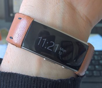

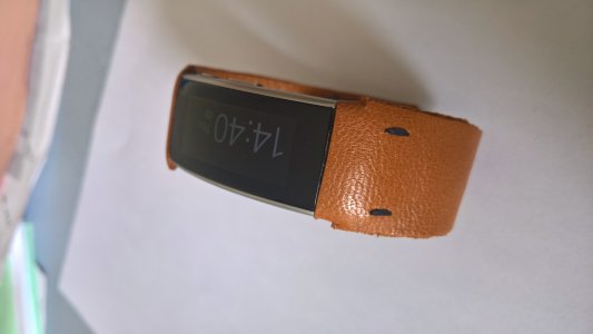

then I glued two straps of leather (with neoprene glue) approx the size of the original straps
then I made the stitching to increase resistance WP_20170309_14_40_51_Rich.jpgWP_20170309_14_40_42_Rich.jpg
then a bit of sanding to polish the sides

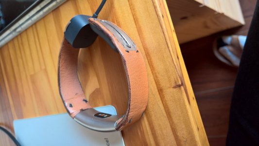

Well I wanted to share that with the other readers here so it may inspire other to make this little idea better....
I did it a month ago and until now my band is aging pretty well...
I didn't had time to write a tutorial but if I can get my hand on cheap band 2 on ebay I may do step by step photos to help...
sorry for my bad english (I'm French and I have to admit that my english lacks a lot of practice......)
I will upload the other photos I have from the teardown of the band and leather repair if I find time
I'll be glad to answer the questions you will have if possible

That's really cool. So when can I send you mine to do as well?? Ha ha j/k
Great work though! Looks good.

Hi I tried electrical tape before but it didn't hold that well.
Here's some pics taken this morning

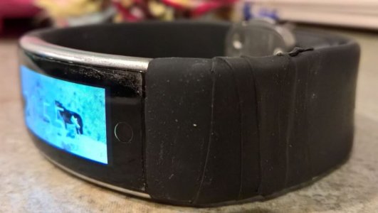

Great job! I used electrical tape to patch up my Band where sunscreen ate the rubber away, but had to redo the repair every few months when the end of the tape came loose. I didn't bother trying a similar patch job on my Band 2, because the strap (the quietly new and improved one at that) cracked and tore half way across.

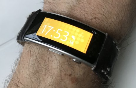

For those who are interested in a less radical repair, I've had good success using Sugru. Sugru is a moldable glue (like playdough) that dries into rubber that is of the same color, texture and feel as the Microsoft Band.
I made a quick video (with a Surface Pro 4) of the repair and posted it here. It has lasted a few months and you can see it is pretty stealthy. https://youtu.be/GpKmRsVVogU

I tried the Sugru fix a few days ago and it has worked great so far. From a few feet, you can't see that it's been repaired since the color and texture match exactly the original rubber. When you get close and the light hits it just right, you can see variations in the surface since it's hard to get it completely flat, but overall very happy with the repair. Time will tell if it will hold up.

As soon as my band began to crack i used a bicycle inner tube repair patch to augment the strap prior to any internal damage. Sanding the strap and trimming the largest patch to fit (largest contact area for adhesive) has worked well for months. Don't use the thin edges of the patch. Trim the edges to the full thickness of the patch and to clear the edge of the Band strap by a couple of millimeters. I applied a patch to the inside and outside Surface of the strap.

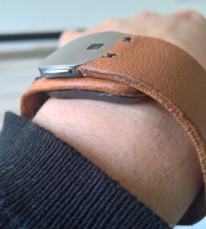

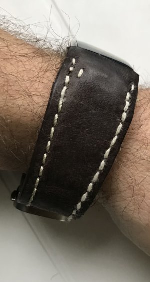

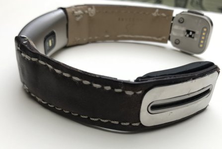

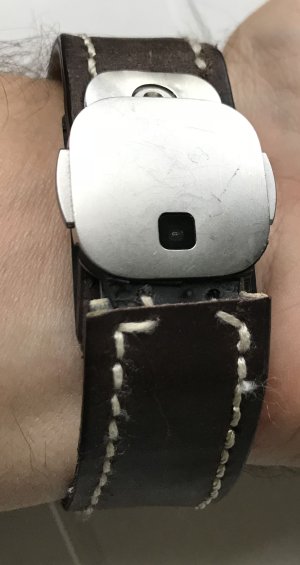

Hi Folks,
inspired by this thread I set out to repair my beloved Band 2. After some investigation I found a leather wristband that fitted quite nicely (https://www.amazon.de/gp/product/B0...ag=techracom00-21&ascsubtag=UUwpUvbUpU3727710). Below are some pictures of the final outcome.
Unfortunately the fix somehow killed the Heart Rate monitor. Strangely, when I start an exercise the LEDs of the sensor turn on and I also get a heart rate but no data is recorded. While wearing the Band it states "Where'd you go? Wear me to see your Heart Rate" without recording any data. Broken Heart Rate monitors seem quite common among the Band 2 as I could find plenty of similar problems on other forums. Resetting the device did not solve the problem. Any hints highly appreciated...
