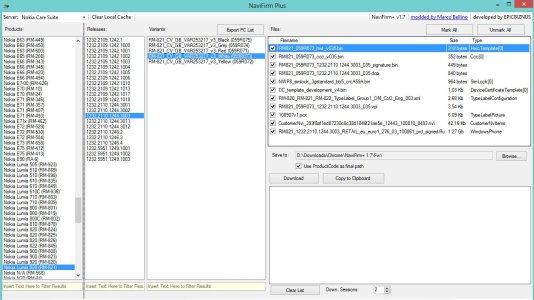

Guys, when you downloaded those firmwares, did you also check the NWP8_simlock something file?
I have an unloced phone and I don't want to lock it with some operator firmware...
I checked all files and my A1-simcard (Austrian mobile provider) still works in my flashed "Orange-Switzerland"-firmware white 920.

059R4H0: RM-821_Orange_CH_VAR260471_12491_001_v2_White
=> The URLs in extras-Info are the ones for Mobiltelefone, Mobil- & Internet-Abonnemente, Entertainment Services - Orange Communications SA/AG instead of Handy - Festnetz - Internet - Mobiles Internet - TV | A1.net (my real provider).
- you will find an app called SBB (Timetable for "Swiss Train") which can be deleted.
- orange is the design-color by default after 1st bootup - just do a restore and you will get your old settings, apps and colours...

It does show Thai and all other keyboards and it shows Thai-letters on the keyboard when I switch to Thai from German or English in the Mail app.
BE AWARE that 4G is gone using this firmware - no problem for me as I don't have a sim capable of using 4G networks.

Just wanted to point out that it seems as if Orange in Switzerland doesn't have an LTE network, which is why that option is disappearing. You might want to try the Belgium Proximus firmware as Proximus has an LTE network. If anyone tries, I would be interested in hearing if your 4G still works after flashing (Proximus uses the 1800 MHz frequency for its LTE which is widespread, but a lot of others use different frequencies and the RM-821 should be able to handle them all - or at least the 2600 MHz which is also widespread).

I have tested the Switzerland ROM
RM821_1232.5951.1249.1003_RETAIL_eu_euro2_345_03_118252_prd_signed
And it does not have the 4G option.
