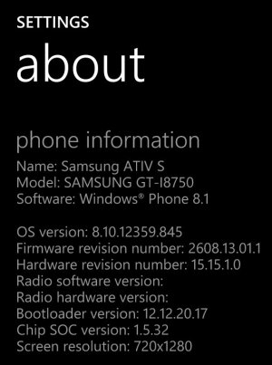

To whom is experiencing the continous reset thing, what firmware are you using? the latest official fw that came together with GDR3?
No, it's a Dev Preview GDR3. The last update I got from Sammy was GDR2 like 2 Months ago. I imagine I'll get their Firmware sometime in the summer. It's a HONG KONG version ATIV S. Here's my firmware:
So it's the firmware that came with GDR2, as no firmware came with Dev Prev Program.
If I were you I'd definitely check any other CSC that your variant allows and switch to one of them (hard resetting in the process) if it would allow you to download a more recent firmware.

What Samsung firmware you currently have? It is the official post-GDR3 one or did you get the GDR3 with another PfD program, thus keeping an even more ancient firmware from Samsung (GDR2 era)?
