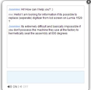

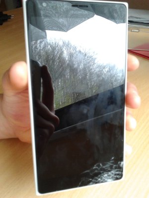

The whole time i was thinking i could replace digitizer by myself at home. But then...

No i failed :D I think that is impossible , because one part on digitizer is glued with diffrent glue and on this part it wasnt possible to seperate digitizer. Then i bought a digitizer+lcd screen and i replace it successfully.
