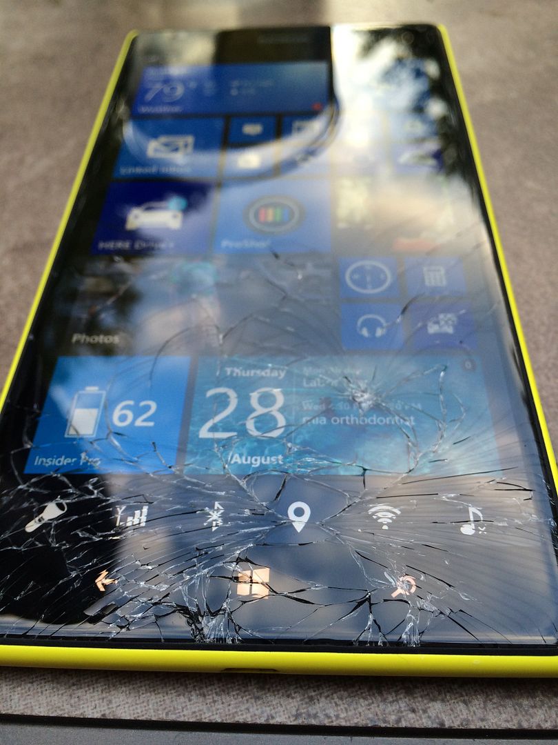

I just dropped mine on a gravel road and totally shattered the front glass. Everything else works fine, I have no insurance with att. What are my options to have it repaired?

Wow that's so sad.. well depending where you live you find a screen replace place. In most malls there is a kiosk every 100ft doing that. Some radio shacks do screen repairs now. Or go on eBay and buy screen replacement yourself or bite the bullet send it to nokia
Yeah, I'm going to send it to Nokia's recommended repair shop, Palco. It looks like it will cost $219. (it really hurts considering that I only paid $49 for the phone through Amazon on a two year contract)

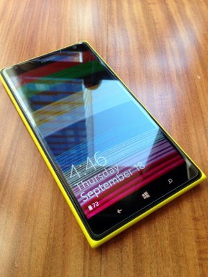

I recently received my repaired phone from Palco... they did a very good job with the screen/digitzer replacement, and also apparently had to replace the back case for some reason. Mine had some scratches on the rear glass over the camera and the back cover was slightly scuffed. Both are now brand new and free of scratches. One thing, however, is that the volume rocker buttons are much closer to the case now, so that they are basically flush and cannot be easily distinguished without looking. A soft case is the only way I am able to feel the difference.
Anyway, I spent a total of $250 for the rapir including insured shipping, so I wanted to get a screen protector offering the best protection for my repaired phone, and decided to install the Inskin tempered glass protector and I'm very, very impressed by this one!
I used the hinge method to lay the protector over the phone, then taped it in place, removed the inner film and carefully placed it down. The fit and alignment is very good, there are no air bubbles at all, and the best part is that this thing has a much, much better oleophobic coating than the phone itself... there simply are no fingerprints whatsoever! Before, I used to feel like I was constantly wiping my phone down.
Another benefit for me is that it is fully compatible with my ProClip dash mount card holder. The protector does not interfere with the tight grasp edges of the ProClip holder like my zagg shields used to. The zagg shields were more expensive too aoround $30 US, but the Inskin is a much better product. I highly recommend this protector!

Looking better... with the new digitizer from Palco and the tempered glass screen protector in place
Close-ups (notice the excellent fit around the speaker)
And all comfortable and secure with a new soft case by Amzer
Thanks for watching and be careful out there with this slippery bugger!

In the images you posted, there appears to be a gap or separation of the screen protector as the edges of the screen curve down. If you look at the pictures closely, there is a border of some kind in the close ups. What is that? In the shot for the front facing camera, the "border" seems to go right through the top part of the lens. Are you sure there's no separation, especially now that it has been over a month?

Still working great for me. I love this protector. There is, obviously, a slightly different color border around the perimeter of the device's screen due to the curvature of the glass, but this has not deteriorated nor become dirty, or discolored in any way. The protector looks exactly the same today as it did the months ago in the photos I posted. Photos are not affected by this at all. I still would recommend this protector.
