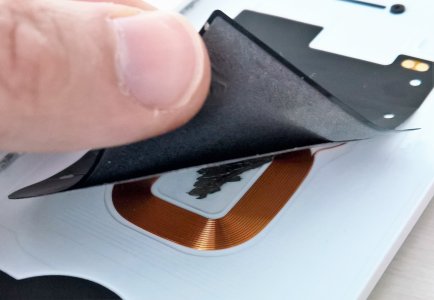

  1. Step 1: Use an Xacto Knife to carefully pry up the sticker that covers the coil (don't rip it - you'll reuse it in about 2 min)

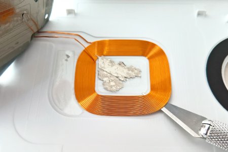

  2. Step 2: VERY CAREFULLY pry the Qi coil up from the phone's back plate evenly so it remains flat. Do not stress the connector wires.
  3. Step 3: Move the coil DOWN about 3cm. Basically, the top of the coil should be about 3-4mm below the center of the recessed ring you un-stuck the coil from. Re-position its connector wires carefully while you do this. You may need to pull about 1.5cm of wire from the coil itself in order to get it into position properly. I guess you want to keep the wires from kinking, and crossing over each other.

Carefully Pry Away the sticker(s).
Work a thin tool or blade around the Qi coil... do not bend it!
Carefully prying away the coil is really important.

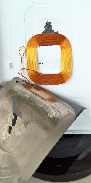

You'll have to slice the little bit of shielding foil away from covering the bottom of the coil so that the sticker / coil detach nicely.
Once the coil is loose, pull a little slack from one side and coil the excess so it stays apart from the other lead. Move the coil down... find the place that works best for you. This is what I did.
I moved the coil a little further down than I said in my last post. Basically the top of the coil is at the bottom of the middle part of the coil recess in the plastic. The sticker / shielding should still cover the entire coil - so don't go too low.

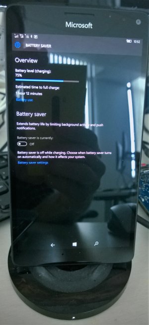

My phone is at 85% between taking the photos and posting this (it was charging at 75% when I took the pictures).
That full charge time (over 1 hour in the picture) has reduced to 30 min, so I think it's charging faster than it estimated.
