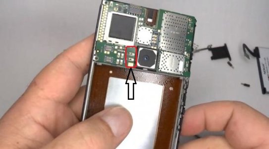

Step 2: Metal Prongs
- The two metal prongs are now visible. They are located right next to the camera section on the motherboard. I took the courtesy to highlight them for you guys :) ;
- These are the prongs we need to bend upwards, i did it using a mini flathead screwdriver. I just simply bent them upwards..

Finally got my T5 driver and fixed it in less than 5 minutes. Thanks for posting, it saved me from sending it away for days!

Ugh!!! I haven't pulled it apart yet but putting pressure on the case and bingo, the LED lit up. I will get the T5 and pull it open once I am back home and not traveling!

Works like a dream. Toughest part was finding a T5 and then pulling the case open. Like T Moore stated, start at the bottom.

Though in my case applying pressure wasn't making the flash work. As I saw later one of the prongs was too flat. All good now.

Thanks mate, I have a Lumia 930 and same problem. Even easier to fix with the 930 as just removed the back of the case and prongs are there. Bent them up and away it went. Easy solution to a very annoying problem.
