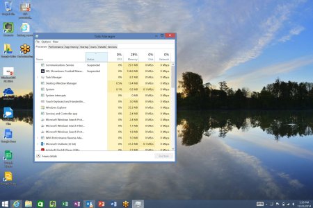

So Here are my suspended apps. One of them, NFL, uses a lot of CPU. You can see it says "suspended". I decided to click out of it and leave it in "suspended" mode when my battery was at 75%. My battery is at 57% 67 minutes later AFTER I closed the keyboard cover and walked away from it.
Sorry..can't tell me that everything is working properly and these apps don't continue to draw power at a dramatic rate.

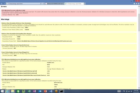

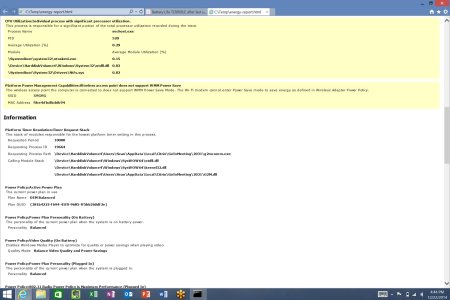

Can someone take a look at this energy report and help me identify what I am looking at here that might be causing battery problems?
