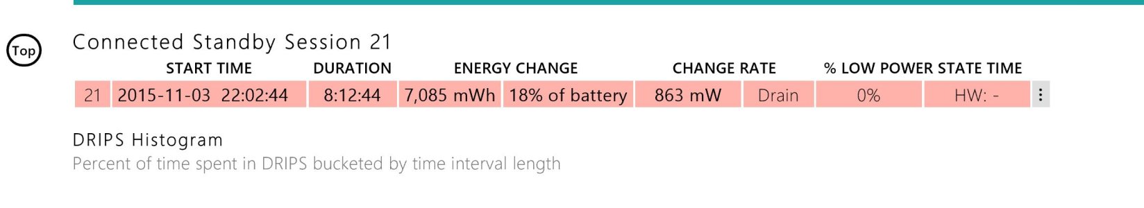

Ran a test last night with a Surface 4 - i5, 256gb with 16gb ram. Hibernation turned off. No open apps. Unit closed and presumably in Connected Standby (or instantgo).
In 8 hours I had a 18% drain - per Sleep Study; however, I cannot really pinpoint why. The graphs in the sleep study are not displaying properly in Chrome and/or Edge.

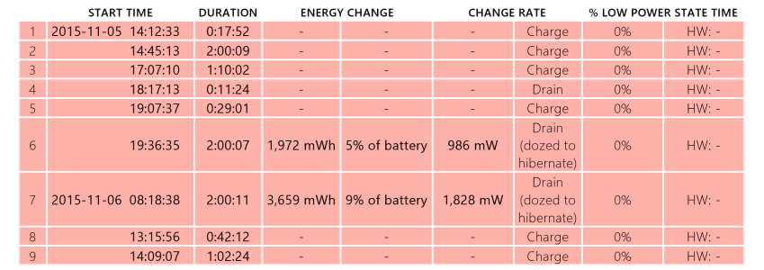

11/5-11/6 (night test):battery beginning @ 100%. Over 8 hours on standby with hibernation turned off, Hello turned on and Edge left open displaying a news site. Battery saver enabled before Connected Standby. Unit placed next to the wifi router. Results - 17% drain or 83% battery remaining.
Overall, I'm seeing anything bad here. This is somewhat close to the Dell Venue pro 11 Connected Standby performance. I am going to photoshop / lightroom for about 1 hour today and see how it does. I expect a considerable drain given these two programs are processor intense.

In looking at your first post, with the graph, I see a drain rate of 863 mW per hour. I think that is reasonable. I get something similar, between 500 and 700 mW (Hello is disabled). The battery is rated at around 39 Wh, or 39,000 mWh. So at that rate, it could last 45 hours on CS, having a drain rate of about 2% per hour. I guess that's good? I don't know what Microsoft says, if anything, what it should be.
You know I can't recall the doc but there was some specification to mfg re: Connected Services battery drain goal of 1% per hour....something really small. I never achieved this with the Dell Venue.... it had it's own challenges..
