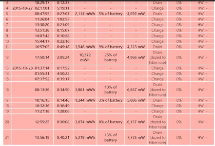

I've seen some posts elsewhere (reddit) where people complain that their surface gets abnormally warm while charging (fans running and all that). I had this issue as well. I ran a sleepstudy to figure out what might be going on.
The attached image should explain what's going on. Curious to see whether anyone else is having this problem. The long and short of it: 0% time in low power state, and 92% of cpu time taken by the 520 graphics driver.

I've had this issue for the past 3 days. My surface hasn't hit lower power state once yet. My last sleep state burned 7775mW of power in only 40 min (13% battery). It seems to only stop draining when it hit hibernate.

Quick question: I took a good look, and noticed that this problem really developed especially on the second day. On 10/26, it's basically doing alright, and then on 10/27 sleep mode starts draining the battery faster than when the machine is in actual use. I cannot understand why, since there was no new software or update installed.
Worse: driver so busy, device never sleeps, runs at full speed, and heats up an awful lot. That was just the overnight, though. On other sleep-cycles, without actual process activity, the device still does not enter low-power state and drains battery at a very rapid clip. About 20% in an hour and a half. It takes my SP3 47 hours to drain 22% on sleep.

Did your sleep report happen to show that the speed of the battery drain increased on the second day? On mine, it clearly shows my SP4 entering low-power state on the first day, and then refusing to do so on the next day. I am in a similar conversation on Reddit, and I've seen a few sleepstudy reports from there that show the same pattern.
