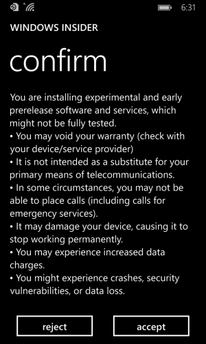

of course I'm compassionate, but blaming Microsoft is not a right attitude. I have been on insider program since beginning and understand my phone can be bricked, and once I had similar problem but in the end i was able to resolve it. And i have posted that later in the thread.
And when it comes to your comparison i would describe it a little different. Imagine someone standing in a middle of very busy road. Most driver would avoid him and he would be safe, but there is always that one ***** who would run him over, Who is to blame then the driver or the the guy who chose to stand n dangerous place. Now imagine his life insurance is like the phone warranty. you loose you leg or arm in this accident, will the insurance company pay out? So in the end only person who choses to use beta software is to blame. If someone in android community bricks their phone because of rooting who is to blame, google because they don't give you root acess straight from the box or person who chosen to do so. If someone tries to flash ios beta and bricks their iphone apple is not the one to be blamed. In the end you have to learn with consequences which came from your own behaviour and not to to blame someone else for it.

I take it you just skipped over the various disclaimers. MS did provide the tool but didn't hold a gun to your head and tell you to use it. When I signed up to the insider prog I understood the risks and tried it on a spare handset. I've rolled back a couple of times with no issue. If i had just the one handset i wouldn't have bothered. I do feel sorry for you but there was an inherent risk and it seems you've been unlucky.
