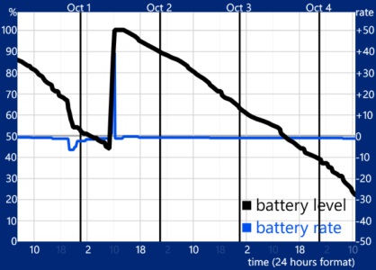

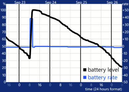

I've seen many people claim that enabling 'double tap to wake' will drain your battery faster. On the settings page where you enable this setting, Nokia even says "this reduces battery life".
But how much? Seems like an important question, but I've never seen anyone give specifics. So I tried to measure it myself. After doing a number of normal discharge cycles with the feature enabled, I did one with it disabled. I didn't change any other settings. I used the phone normally in both runs - very similar usage.
I found that disabling this setting produced no significant change in battery life. In both runs that I compared, my battery level was at about 20% after about 3 days. See the attached graphs for my results. The first graph is with the setting on. After just a little under 3 days it was very close to 20%. The second graph is with the setting off. After exactly 3 days it was a little above 20%. These results are not exactly the same but I don't think they're significantly different. Not as different as I was expecting.
If anyone else has performed a similar test, I would be curious to know your results. For now, I'm going to leave this setting enabled with a good level of confidence that it has minimal impact on battery life.
