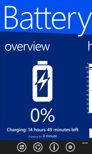

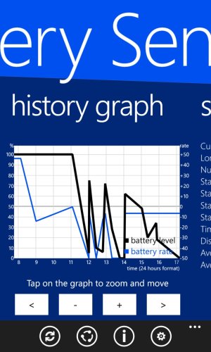

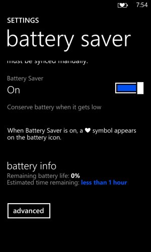

It started last night and it has continued to occur today.
I left it charging all night and it says that it was at 100% but after a few minutes it goes to 0% and turns off.
I then have to soft reset for it to turn on and the battery is 10 or so less than before it went directly to zero.
I have been doing this for the past few hours but it is a hassle because I don't know if my phone is off or sleep with the battery activity going on.
here are a few pics from battery sense and settings to show what I mean.

How does it hold using it with the charging cable attached? I would uninstall any app you d/led the past week and see if it helps first, especially the ones that use GPS.
Is your battery hot during this up down process.

With the cable attached, it still decreases but steadily instead of a steep drop to 0%. I might try deleting some of my apps. what is weird is that after I soft reset, the battery goes back up. I would think that it would be a bad battery not retaining energy but once I hard reset, the battery percentage goes back up, which is very odd.
