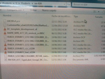

Copy the downloaded files to the corresponding directory in your computer, and set the program to offline working mode, charge the rom in the program (before, rename all of the files and remove the leading serial numbers like the picture below) and follow the steps to flash your phone, let it restart and that's it.

3. Put the files in this folder. (C:\ProgramData\Nokia\Packages\Products (you have to then place the firmware in the folder of your variant code, ie RM-824) – Note: this is a hidden folder so you’ll have to unhide it in windows explorer. You may want to place all the files except “usergroupsconfiguration.cfg” already in the folder to a new folder named RM-824backup as they may cause the fix to fail.

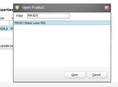

7. In Product Support Tool choose File > Open Product
8. In the filter box type RM-824 (Image below is similar)

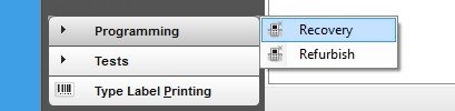

IMPORTANT EXTRA STEP: IN THE BOTTOM LEFT SELECT PROGRAMMING >
I tried this first.
RECOVERY
