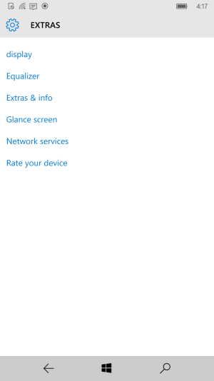

Now here is another for the "WTF" category. I have two identical 640s with the same OS, same build, same updates from the store with different settings than each other. I was wondering why my 640 didnt have touch settings for "double tap to wake" and "vibrate when i touch the navigation keys". But i got my new 640 and it had those settings. It also has Call & SMS filter, Lumia motion data, and Touch. I thought it might be because i didnt update the apps from the store, but i got all the updates, everything is exactly the same between both devices. Splain that one?

For those suggesting it might be the firmware, may have a different firmware version...i just checked settings...about...they are identical. Same exact firmware, OS, hardware revision number, radio software, chip version, everything on that screen is exactly the same...i can post screen shots if you like
Identical software/firmware. 640 ATT GoPhone both purchased at walmart...one has several more settings in "extras" than the other. The reason im making a deal about this is i want to have those settings on MY phone too, to adjust stuff like touch and the one that has all the settings is the one im giving away.

Go to Display and check scaling. Are they both on the recommended percentage?
Today I changed the scaling from recommended to a lower one started getting all sorts of weird crashes with some apps and bugs. Store had to update all my apps but not all of them were in the update. So not every app designs outside the recommended scaling? Not sure.
Nope scaling is different but I never thought that would have any effect, why should it? So I change my scaling different and all of a sudden Touch settings disappear lol. That's ridiculous if that is the reason... ill change it back and report back.
