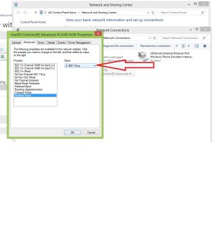

For this make sure your wifi network card in your laptop is using 802.11 b/g wireless mode,
This mode uses 2.4GHz bandwidth of frequency, which is detectable in mobile devices like ours, If your laptop transmits 5.2GHz or like that, your device will not find it!
so to make sure your device is using 802.11 b/g mode,
Steps:
1.Open network and sharing center
2.Click on "Change Adapter Settings"
3. FInd your wifi card from there
(mine is "Inter(r) Centrino(r) Advanced-N 6200 AGN"
4.Right click>go to properties > configure>Advanced>Wireless Mode>select 802.11 b/g
For help see the picture.
And use the connectify.
It will connect for sure and enjoy!
