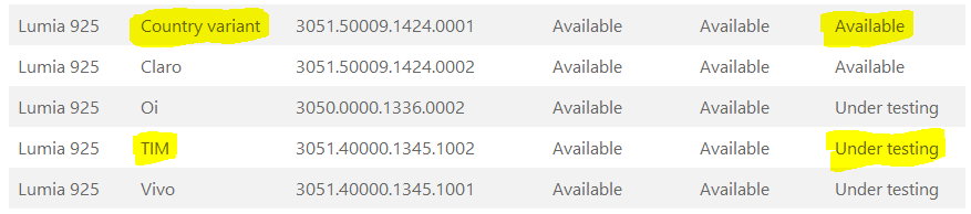

Flash a Country Variant ROM for your region onto it - a search on here will bring up a few guides. That's the only way to remove the carrier stuff. BUT, that won't necessarily let you receive updates faster, as we are finding out with Cyan.

Unfortunelly in Brazil there is carrier that takes a loooonggg time to available the update.

Correct - it will be just like a SIM-free phone bought from the store. Same serial number+IMEI (it's actually illegal to change those so they will never get changed by legitimate means).
As said before, there are guides on here for doing it - just remember all the risks and make sure anything you want to keep is stored safely elsewhere.
