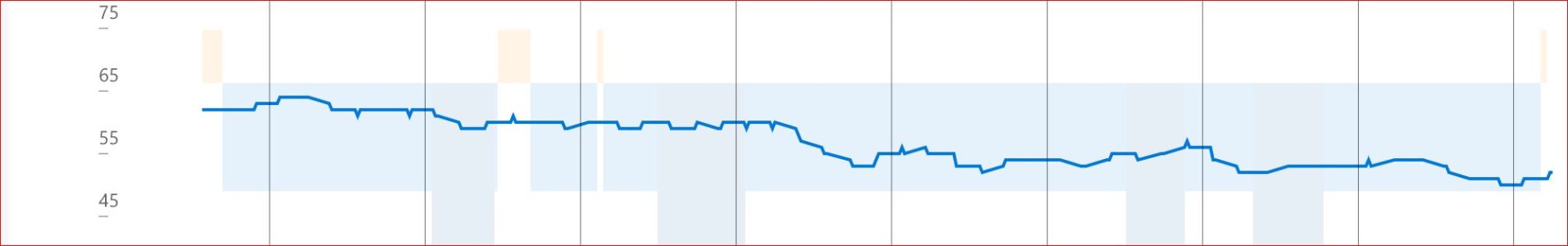

I did buy the Band 2 a little over a year ago, and it is proving to be very helpful indeed for tracking my afib. As an example, this is a monitored night of normal sleep yesterday:

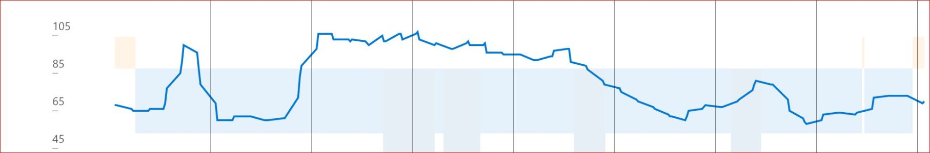

This is a night of irregular heartrate, the difference is obvious, and the Band clearly shows me when my episode began, and its relative rate. Note the difference in the axis scale too:
So I find it very useful. One other point, if you need more granularity in the heartrate during the day (because if you are at rest the Band will not be very active either), just set up a "guided workout" and start that when you start an afib episode. I set up a 4-hour walking workout that I use, and it will record your heart rate at a greater frequency.
