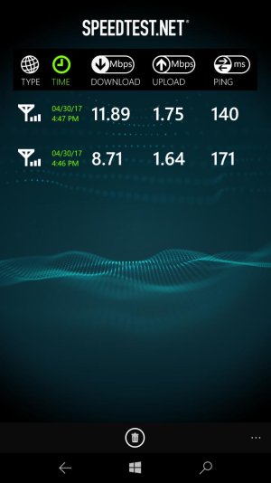

I picked up the Idol 4s last week and started using it on AT&T Wednesday. I'm in south-central Pennsylvania between Lancaster and Harrisburg. I'm happy with the phone so far (clear upgrade from the Lumia 520, 635, and 640 I've used) but I'm not getting great speed on LTE (see attached). Any tips you have would be appreciated. Also, what is the best camera app for this phone?
damn that could be a great speed LTE in Costa Rica lol i only get 3 MB at top :cry:
Re: Using the Idol 4s with W10M on AT&T
I will check on the LTE speed thing, I never really cared much about how slow webpages load and such so probably never noticed. I never had a video lag though...If you get band 12 in your area and are on LTE, try toggling roaming on to see if there is a difference in speed. Just curious.
Supposedly the best camera app could be ProShot (UWP app). But check out this thread for more on that.
So I am in basically Phoenix AZ. I get double the speeds you get right now. There are a couple of caveats here. I am on the T-Mobile ROM and Firmware. Not by choice...long story on that one...
I had no roaming enabled when I tested. Then I tested with roaming and got slower download speeds. So it could just be the fw for the T-Mobile settings. Signal strength is almost always 4 to 5 bars on this phone everywhere locally out here though. Also my apn is defaulted to nxtgenphone since VoLTE services is provisioned on it. Any changes from your end?
I've gotten up to 90Mbps down with an AT&T data SIM on my iPad. Location is east of Harrisburg over towards Philadelphia.

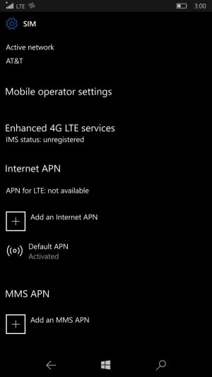

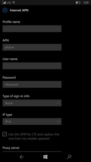

What APN is set? I used to think it only occured when nxtgenphone was used. Then recently started getting it on the APN phone too.
My APN is phone. Sorry I fell off the map on this thread.
