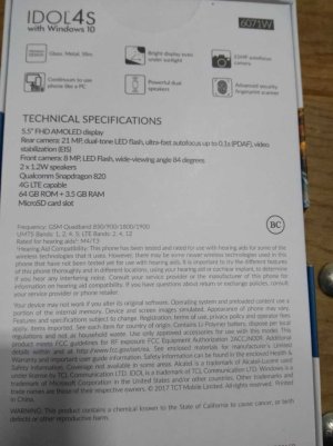

I will check the box 1st then will decide some people get UMTS 1 BAND ON THE BOX
Re: Using the Idol 4s with W10M on AT&T?
The phone that i have purchased, but not in my hand has UMTS 1 / 2 / 4/ 5. Please find screenshot of the box.

FedEx just delivered mine. Box is exactly like the posted photo. I am going to get it activated with my cricket sim and check it out.

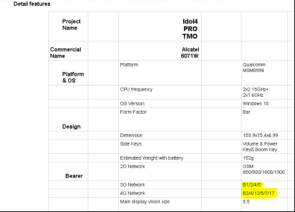

I contacted Alcatel US support via their website. They responded that the phone support LTE Bands 2/4/12/5/7/17 with proof of their specific sheet. :wink: I am still happy to take this phone for the deal.
