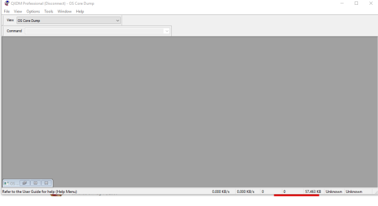

Can you give me link of QXDM and QPST what you used i am getting error QXDM

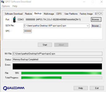

after this i can not get data from 4g sim which use band 5 i am getting signals but not connecting any idea why?

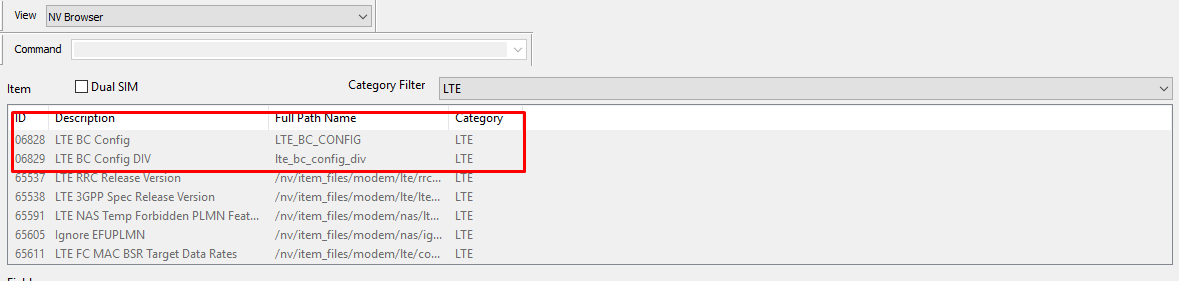

those two value, 0829 was deacive and end of the day i restore qcn and changed back to default value.

In QXDM you need to setup the connection to the phone. What you are showing me is not an error. They are uneditable if QXDM has not connected to the phone to read them yet. Did you read the necessary threads on XDA to understand how to edit those values?

1. Currently my LTE BC config has 67674 value if i add Band 3 only with keeping existing those band what would be the value then?

1: It should be 67678
Going back to your older posts...If 06829 is disabled (which it was on mine do not enable it). You would only change the one that is active. I made the choice to activate (enter values there and the phone started to behave erratically).
