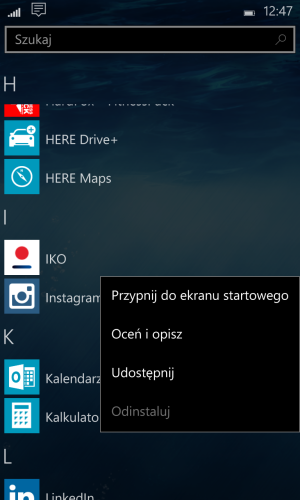

Hi, I have an unusual problem. In the previous build, when I tried to update my bank app, an update error occured. Unfortunately, from now on I can neither uninstall it (because in list menu this option is unactive) or update correctly. Too bad, because this application is quite necessary to me. There is an option to remove it manually? :unhappy:
You can try from the app Storage > phone > apps and games > search your app and tap on it > remove
I had the exact same problem with metrotube on 10136. I looked at it for a while, but was neither able to diagnose or correct it. I had to do a hard-reset to get rid of it.

As always with the TP, do a hard reset and move on. I have not witnessed the problem on the newer build yet, so I'd advise updating before doing the next TP test -run.

This is not the known update/install problem. It could ba an uninstall problem on 10136.
