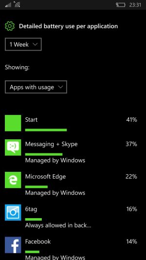

I don't think it's normal for start to use so much of my battery. Doing a hard reset now...
Already did that months ago, no idea why the usage is still that high....

Messaging + Skype will show up as "one element" even when signed out from Skype because that is the overall name of the app
No. If you log out from Video Skype, you'll be find app doesn't show skype anymore. Try it. That's why drains so much
I still havent done this procedure, my "messenging+skype" doesnt show much drain(like 1-2%) on battery saver ;d but will it allow to uninstall skype video forever?
