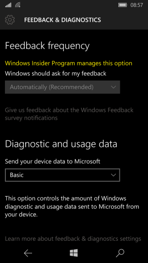

Well I just updated, after having previously tried this build for a day, only to find it almost useless. Yeah it seems faster, but the severe battery drain, and the full screen video flicker issue were deal breakers.
So I updated again, to the same build, because of course I did. I switched feedback submitting from full to basic, because supposedly that fixes the battery drain. Then, it now appears, most videos played from the photo app DON'T flicker anymore. Well one did, but 4 others didn't. Edge video playback is fine, so is mytube.
So far... not to shabby... If I manage to get decent battery life I can live with that flicker until the next build.

Just wanna say this. Once I changed to only sending basic diagnostic and usage data (as opposed to the previous settings of enhanced, or full), battery life seems to be excellent on my 735. On idle for about 2 hours plus some quick facebook and browsing and I only lost 2%.
The flicker issue still persists though.
So this is a life saver?
