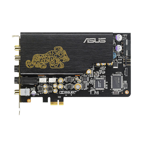

That is why, if you want to push your headphones to make them provide to their best of abilities, the best sound, you need a dedicated sound card or sound system, this include having a clean, interference free sound, and power to operate high ohm headphones. That is why, some people, such as myself, purchase dedicated sound cards. In my case, I have the ASUS Xonar Essence STX.
You can notice from the picture, that it features a dedicated 4-pin power plug, where it gets the power from the system power supply (so yes, a good power supply is a must, lucky it's not too pricey to get), EMI shield plate, and well, it's big... definitely something that can't fit in the Surface Pro, let alone a 17inch laptop.

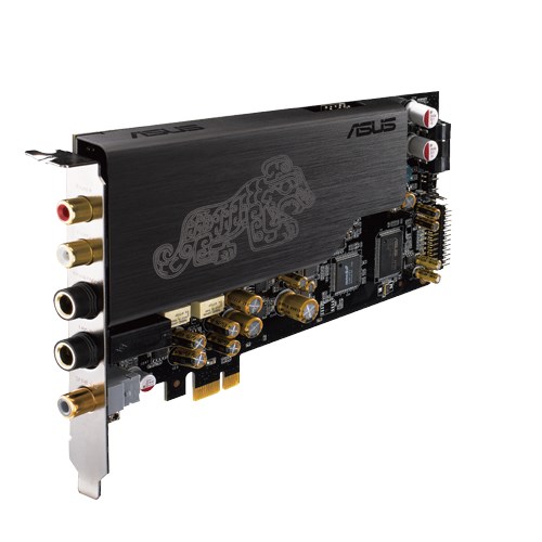

Here is a side view:
It's also costly. A dedicated sound card, a good one, like above, is around 150-200$ U.S, depending on where you get it, if you wait for specials.
