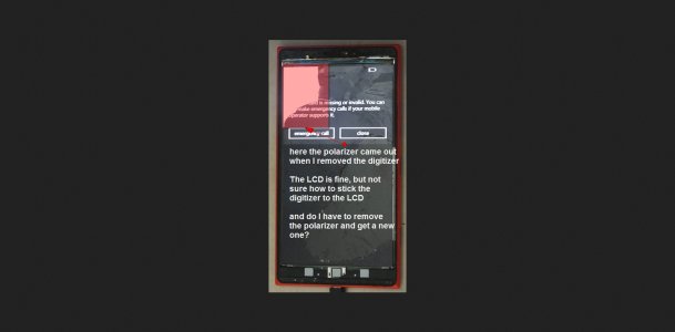

b) Has anyone been able to successfully replace only the digitizer? Actually I have managed to separate the digitizer from the LCD. The screen shows up fine, but without the digitizer I am not able to use touch functions. Does anyone know how to stick the digitizer to the LCD? Also there is a black colored transparent film on the LCD. What is that? As a small piece got pulled out while I was removing the cracked digitizer and in that portion its now white and I can lightly see the screen.

Most the cheap panels are OEM displays but not OEM digitizers. They use a liquid adhesive to bond the digitizer, they don't sell it in small quantities that I know of. The black film that came off is the masking and polarizer film. Ideally it's more effective to just buy the whole assembly as most the digitizers aren't that bad. Just with a reputable seller.

yeah you're gonna have to replace the polarizing film. I burnt a small part of mine, so I ordered some polarizing film and will have to replace one of mine as well.
If the chip on the digitizer is not Synaptics your wasting money. ONLY the Synaptics chip is 100% compatible with cyan and denim. This goes for both the Glass/Digitizer and the full assembly.

I am still finding a way to do it. Here is how my phone is separated from the cracked digitizer. Still working LCD but no touch function as there is no digitizer.
