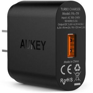

Anyone have one of these perhaps?
AUKEY 18W USB Wall Charger with Qualcomm Quick Charge 3.0
This one does have 3A output which is same as AC 100 that comes with 950's, you can plug in any cable you want as well as charging plate, which should work?
