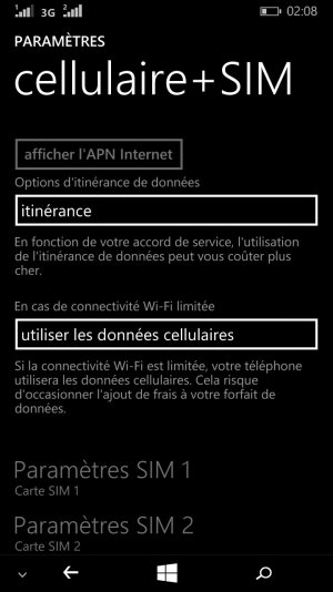

For me, both sim cards have stopped. In the cellular menu +sim, I cannot find my sim cards.
Indeed, it?s displayed in grey ?Sim 1 setting? , sim card one, and it?s the same for im 2.
I can?t put my phone in plane mode, and I have then to restart my device. It works fine for a time and? and restarts again.
I?ve changed my internet sim card, but the problem persists. I?ve permuted the Sim cards,,, it?s the same.
I add a screenshot.
